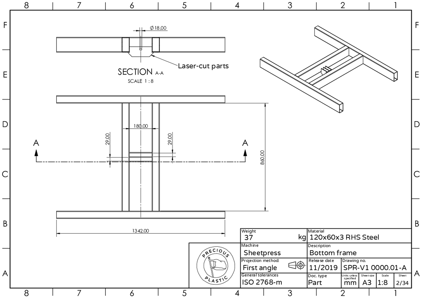

| 📄 SPR-V1 0000.01-A Bottom frame.jpg |
206.7 KB |
2024-10-26 |

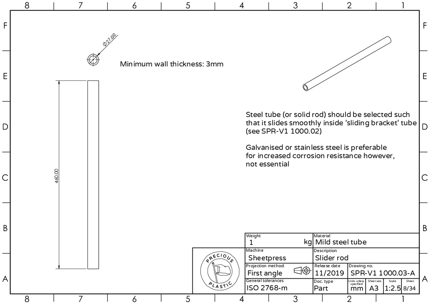

| 📄 SPR-V1 1000.03-A Slider rod.jpg |
201.2 KB |
2024-10-26 |

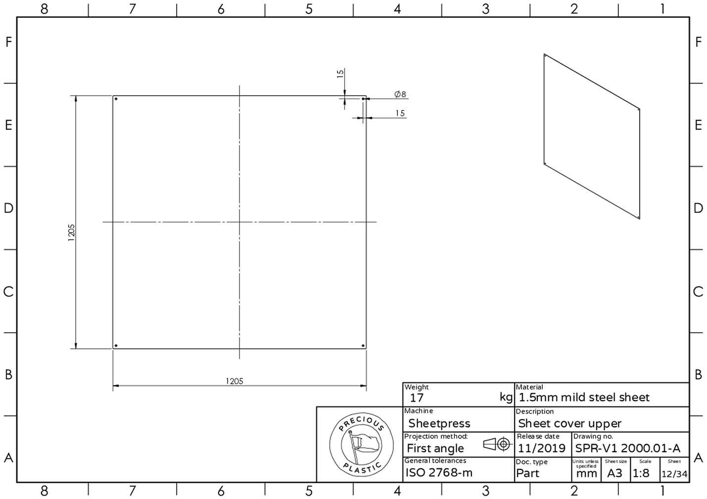

| 📄 SPR-V1 2000.01-A Sheet cover upper.jpg |
138.8 KB |
2024-10-26 |

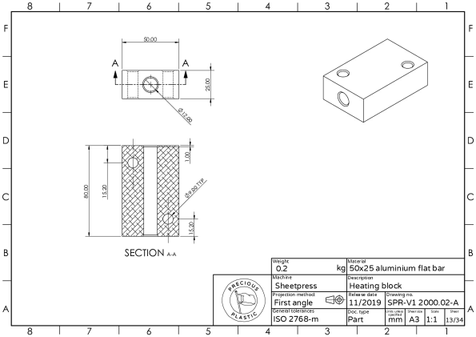

| 📄 SPR-V1 2000.02-A Heating block.jpg |
226.8 KB |
2024-10-26 |

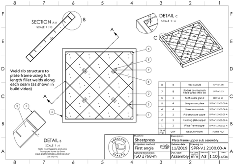

| 📄 SPR-V1 2100.00-A Plate frame upper sub assembly.jpg |
444.5 KB |
2024-10-26 |

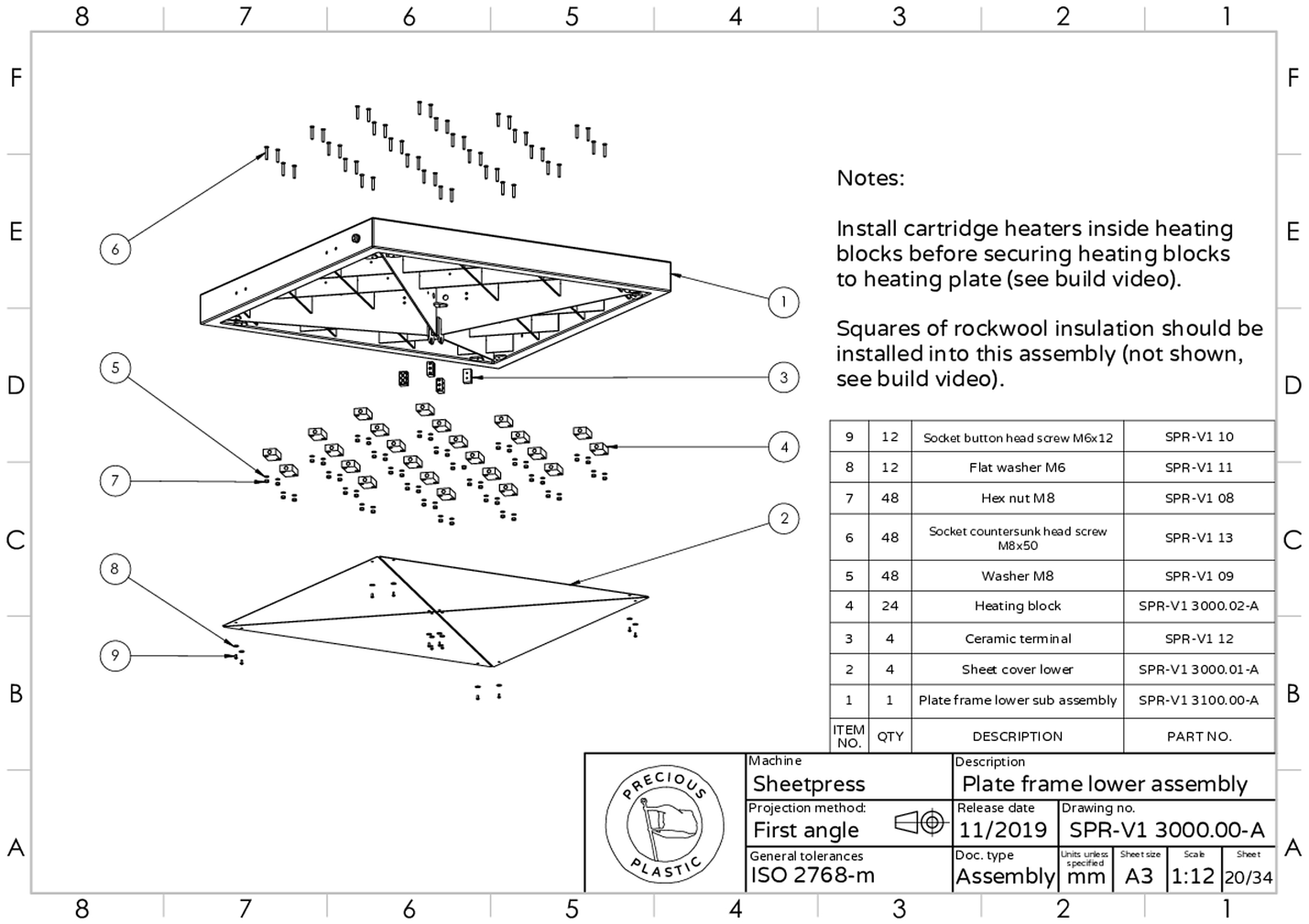

| 📄 SPR-V1 3000.00-A Plate frame lower assembly.jpg |
387.5 KB |
2024-10-26 |

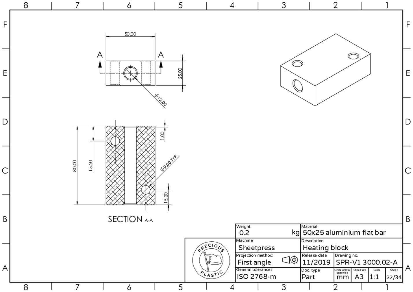

| 📄 SPR-V1 3000.02-A Heating block.jpg |
226.9 KB |
2024-10-26 |

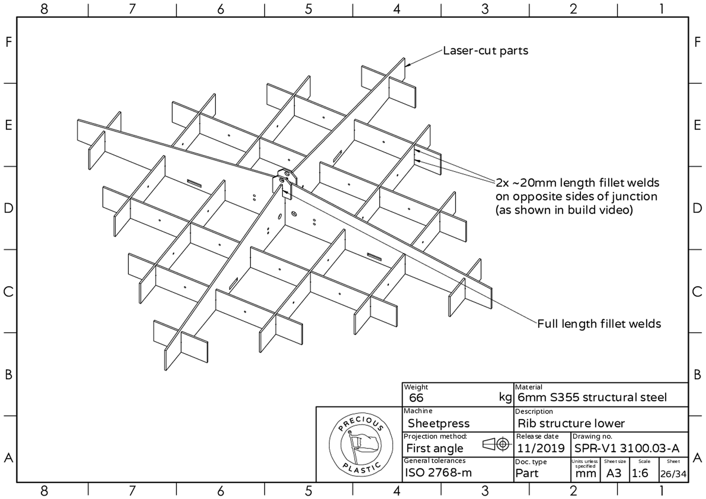

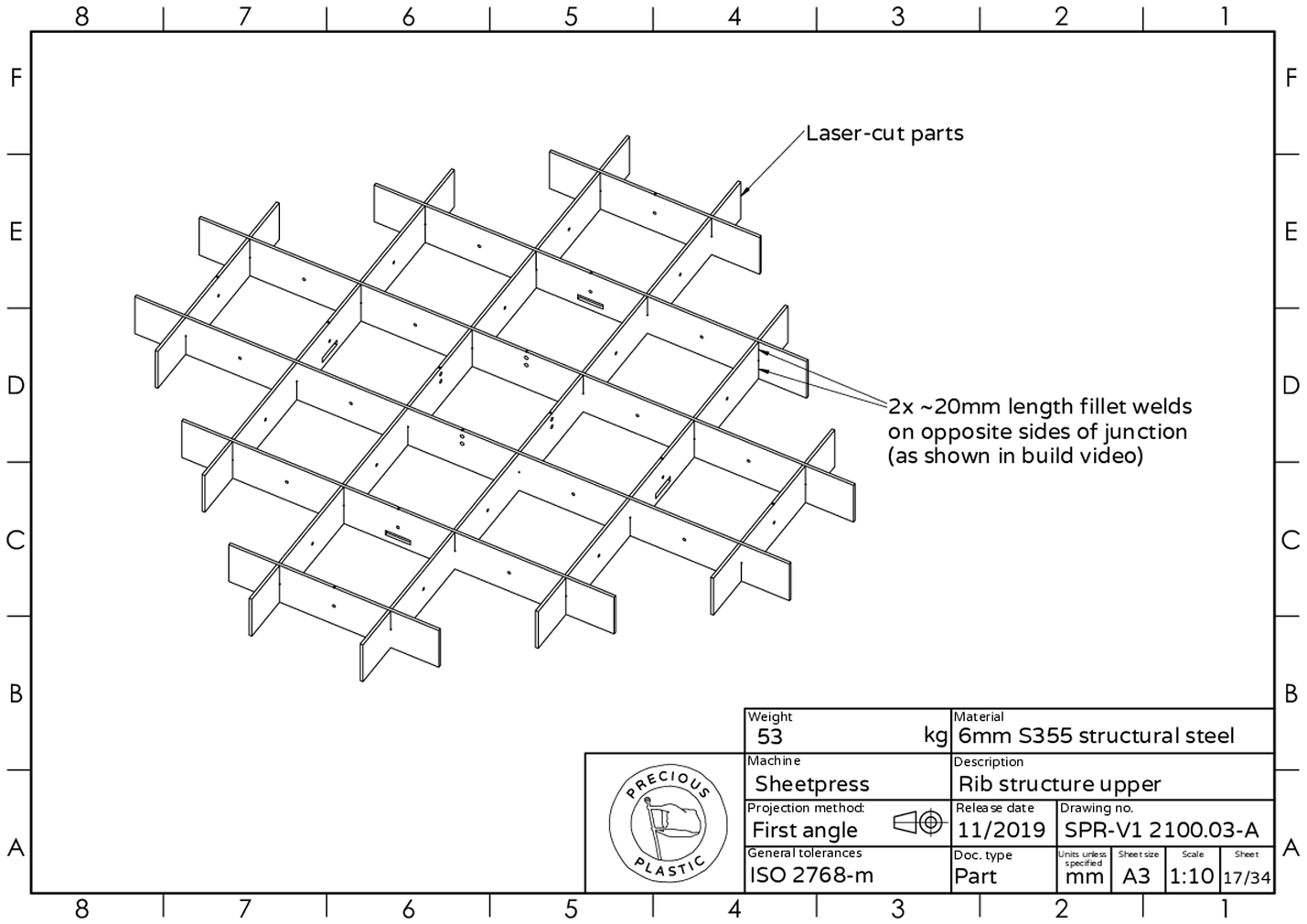

| 📄 SPR-V1 3100.03-A Rib structure lower.jpg |
341.0 KB |
2024-10-26 |

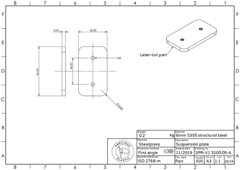

| 📄 SPR-V1 3100.05-A Suspension plate.jpg |
163.3 KB |
2024-10-26 |

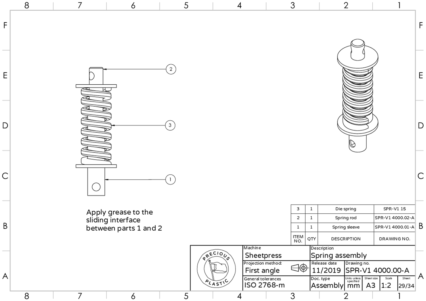

| 📄 SPR-V1 4000.00-A Spring assembly.jpg |
247.9 KB |
2024-10-26 |

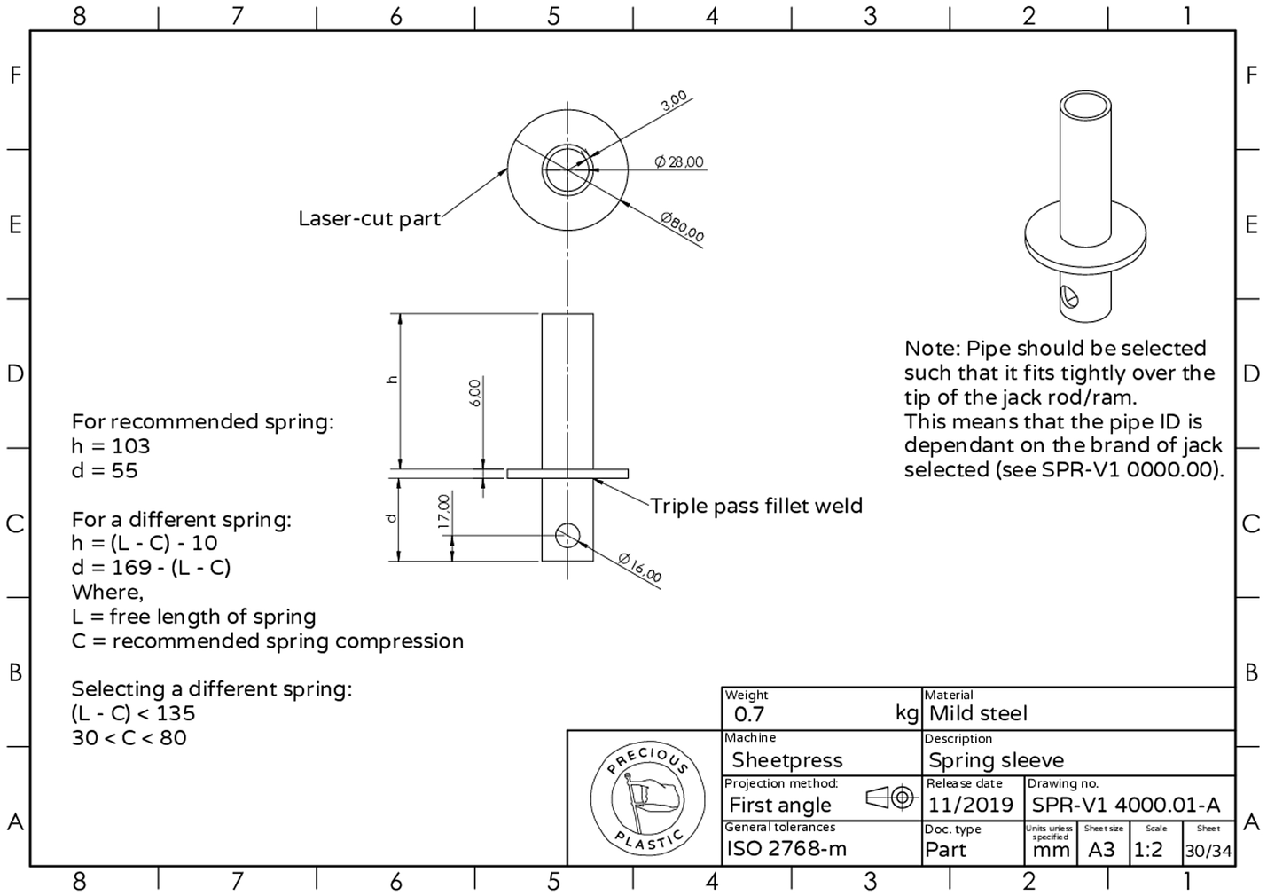

| 📄 SPR-V1 4000.01-A Spring sleeve.jpg |
277.3 KB |
2024-10-26 |
