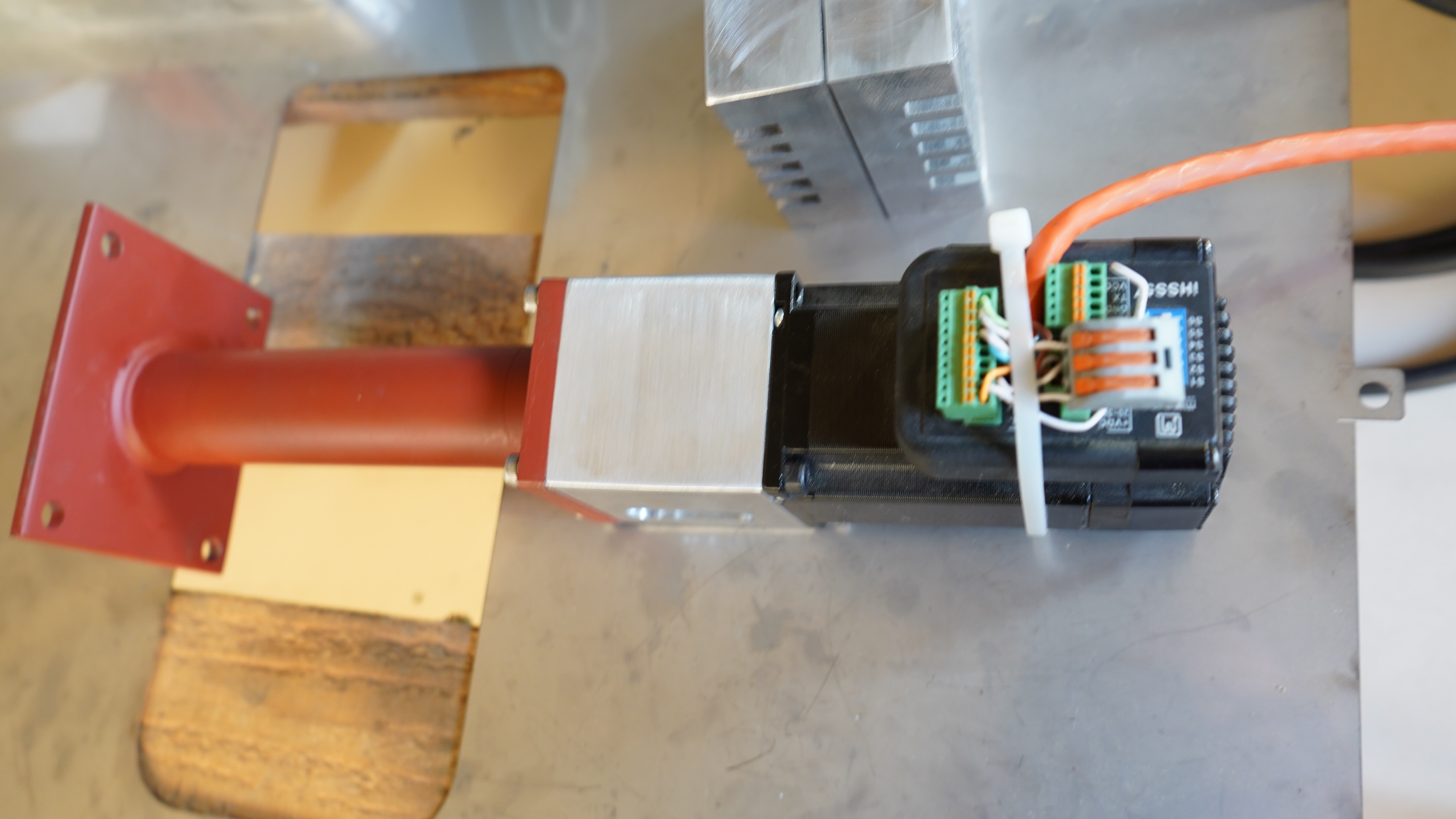

Clearpath - Teknic Servo
-> White (Input A+) -> DIR -> (MB_STEPPER_DIR_0 -> CONTROLLINO_D18)
-> Black (Input B+) -> PULSE -> (MB_STEPPER_PULSE_0 -> CONTROLLINO_D17)
-> Blue (Enable +)  -> 24V
-> YELLOW (Input B-) -> GND
-> Brown (Input A-) -> GND
-> Orrange (Enable B-) -> GND

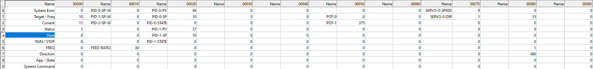

To monitor and control the system, please open printhead-poll.mbp with MbPoll_v9.4.0.exe
Example Example Google Sheet
Simulate Modbus for Development
  • Please use MbSlave_v7.3.0.exe to start a Modbus-RTU master on TCP. You can use the ModbusPoll app to verify your code.
