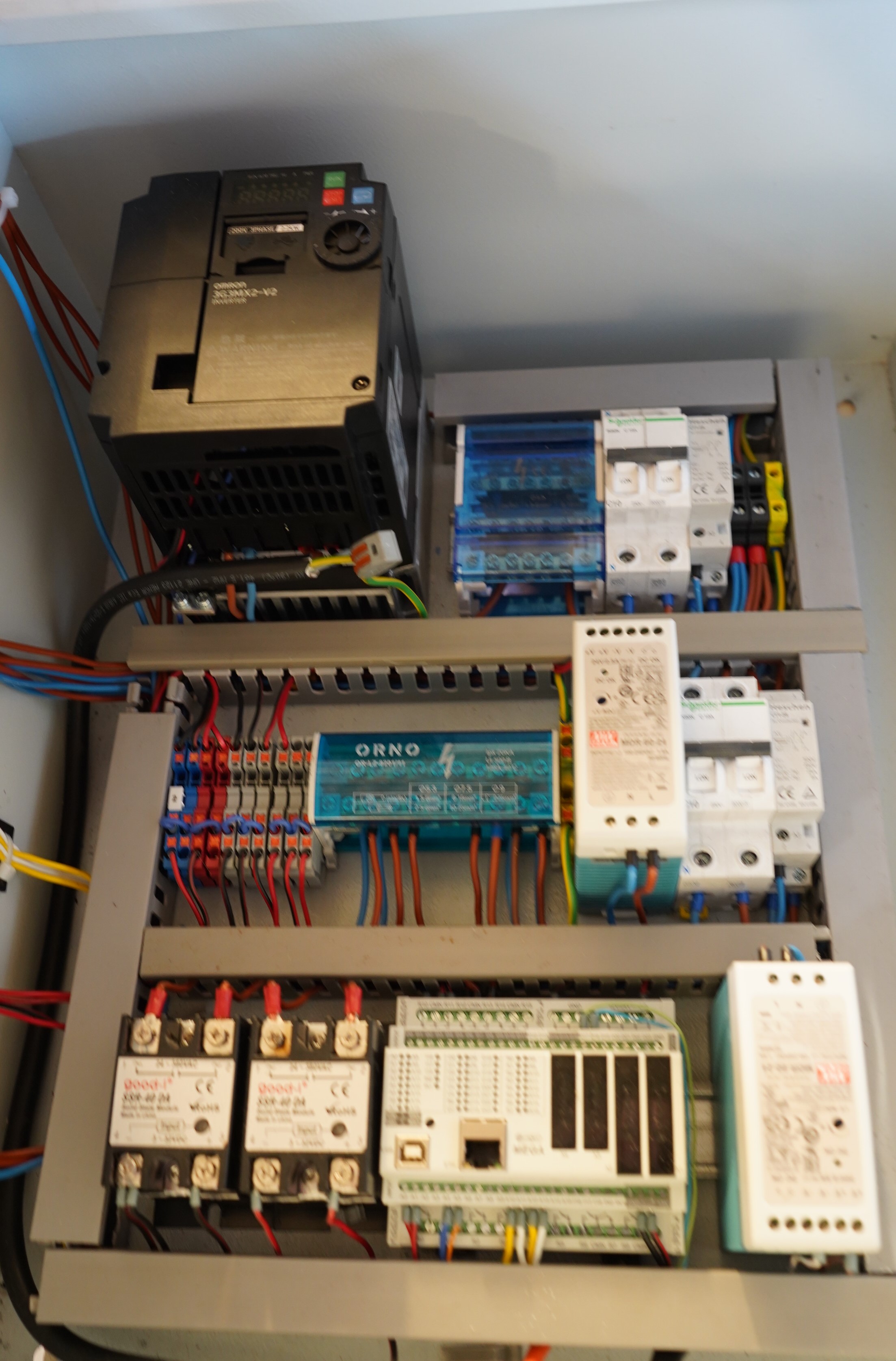

Omron MX2
  1. Please refer to the OmronMX2 - Modbus setup guide../vendor/omron/P641-E1-01_EGuide_CJ_Mod485_OMRON_3G3MX2-V1.pdf(Section 7.2.2)
In case the terminal labels mismatch the documentation, please use SN for (A-) and SP for (B+)
1.1 Set basic parameters
  • Max. Frequency, depending on gearbox, A004 = 75Hz
  • Acceleration time, F02 = 2secs
  • Deceleration time, F03 = 2secs
  • Output current on AM terminal (connect L to circuit GND!) as 10V : C28=01
  • Enable Brake - A051 = 01 (../vendor/omron/I570-E2-02B.pdf : Page 105)
  1. The firmware expects the VFD at Slave-Address 1 !
Additionally, please check the user manual../vendor/omron/I570-E2-02B.pdf)
2.1 Modbus settings - Page 297
  • Parity : None - C74 = 00
  • Speed : 9600 - C71 = 5
  • Slave Id : 1 - C72 = 1
2.2 Control settings
  • Frequency selection - A001 : 03 (Modbus)
  • Command selection - A002 : 03 (Modbus)
Please restart the inverter after changing those settings!

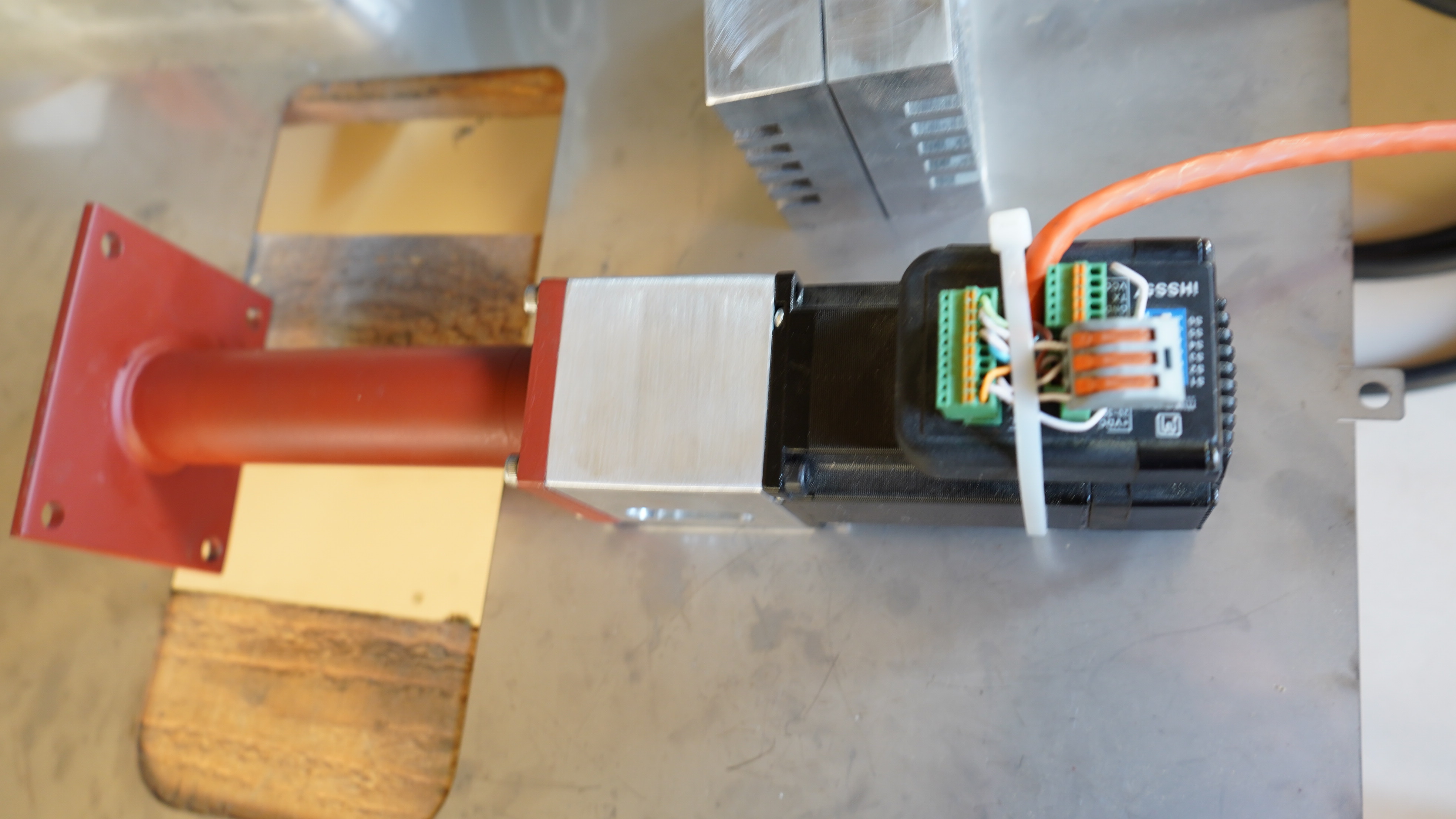

Clearpath - Teknic Servo
-> White (Input A+) -> DIR -> (MB_STEPPER_DIR_0 -> CONTROLLINO_D18)
-> Black (Input B+) -> PULSE -> (MB_STEPPER_PULSE_0 -> CONTROLLINO_D17)
-> Blue (Enable +)  -> 24V
-> YELLOW (Input B-) -> GND
-> Brown (Input A-) -> GND
-> Orrange (Enable B-) -> GND
